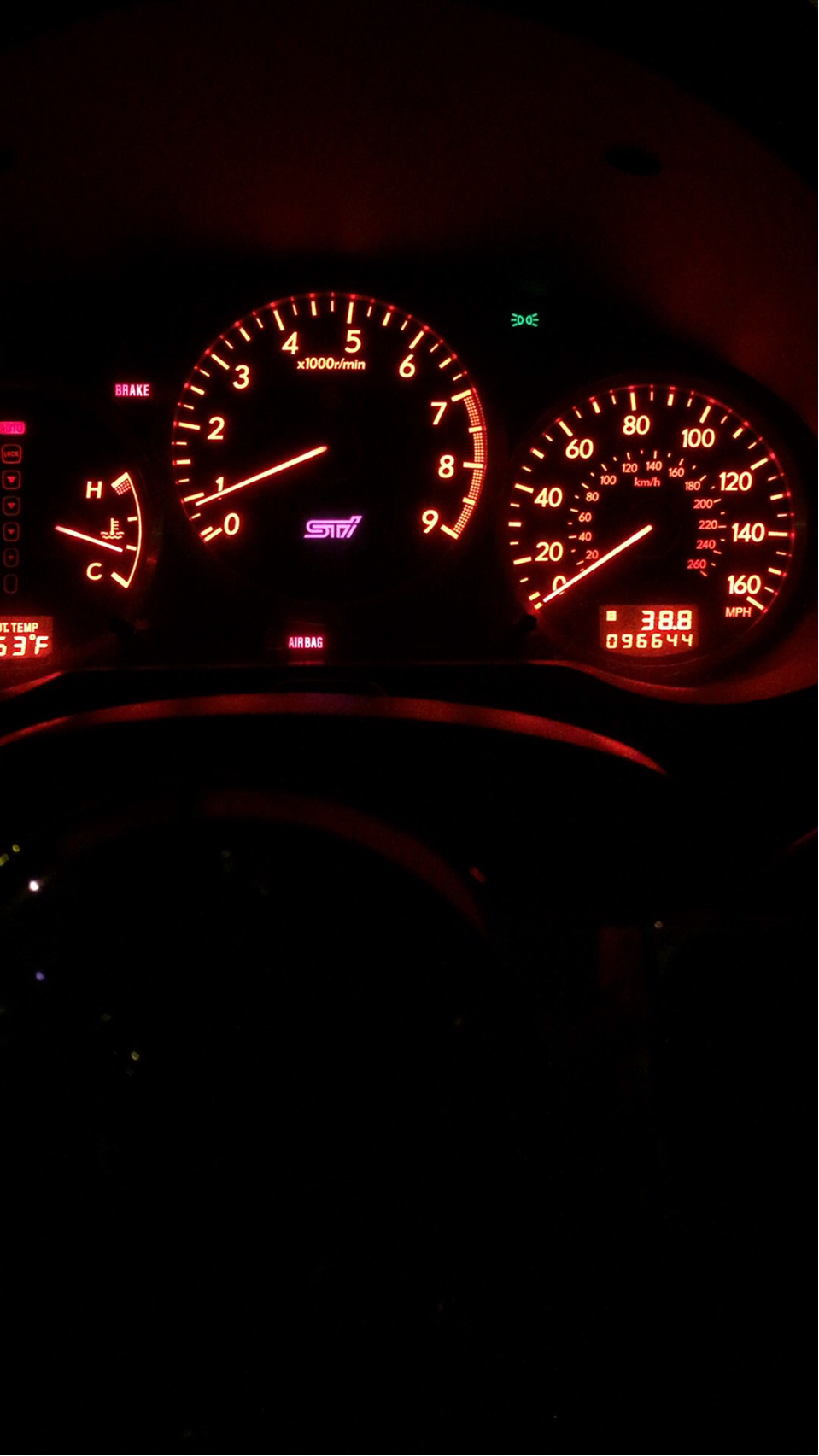

Any idea what might be the issue?
The rpm jumps up and down for a while. It stables after another few minutes but it still feels like it wants to stall slightly here and there

You're DBW, so no IACV to clean - perhaps dirty TB plate? Bad wire/connection to TB plate?
Check all engine grounds; do the GND mod, esp to TB. my 0.02.

Is your BOV recirc or atmospheric?
Its the worx bov
I believe the worx is recirculated. I read something about 50/50 vent and recirculated
Old Jul 14, 2015 | 11:50 AM
If you have the stock BPV, you could try throwing that on and see if it makes a difference.
Is your car pro-tuned?
Tbh im not really sure if its pro tuned or not. I got the car about a month and a half ago. Im trying to pick up a stock bov to see if thats going to work. Any ideas how much a retune at a professional shop would charge?
