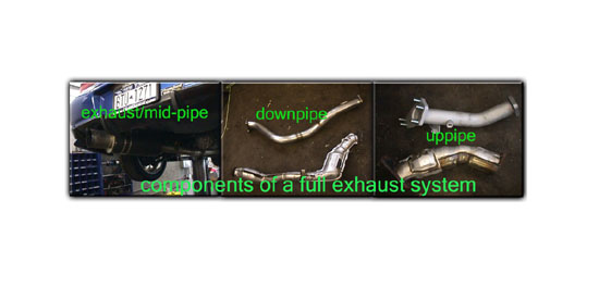

hmmm. i thought that the Perrin downpipe would only replace the front catalytic converter as shown in the diagram here (scroll down, it's like four posts down):
https://www.i-club.com/forums/showth...threadid=14107
and not the rear cat. if the car will pass emissions with the pre-turbo cat gone, and the stock downpipe and rear cats in place, i can't imagine that it would fare much worse with the Perrin high flow cat and the stock rear cat, if in fact the Perrin downpipe allows you to keep that unit.
