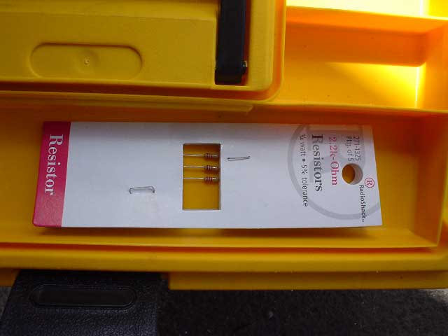

As for the CEL on the uppipe, expect one. The factory uppipe EGT sensor is on the back side of the cat in the stock uppipe. Once the cat is out of the way, there will be a LOT more air-speed hitting it, thus causing more voltage, thus causing a CEL. I know I got one in my aftermarket uppipe, and you should EXPECT one with a gutted pipe for the same reason.
However, FEAR NOT.
Go to Radio Shack and buy a 2.2k Ohm resistor (1/4 watt). A pack of 5 is roughly $1.
Take one of them, bent it into a U-shape and then loop the ends (so it looks like a U with bulbous points on top).
Find the cable leading from the uppipe. This is the EGT Sensor cable. Follow the cable from the uppipe to where it clips (underneath the boost solenoid cover).
Unclip it.
Stick resistor into holes (complete the circuit) on the engine side (not the sensor side) of the cable. It will only go INSIDE one.
Wrap cable with copious amounts of electrical tape.
tie off sensor cable with zip tie.
You are now CEL free. I'll post some pics in a few minutes.
-Etch
Old Apr 22, 2003 | 06:30 PM
EtchyLives's Avatar
Posts: 2,518
From: Plymouth, MN
This is what a resistor package looks like
