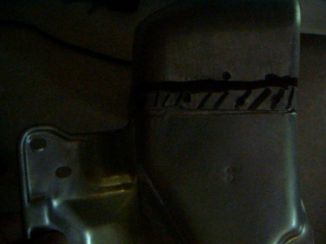

if your curious on how to cut the heat shield so ur intercooler won't
be heat soaked and you'll keep max power at high temps here it is.

Note #3 - The easiest way to get all of the bolts off the upper part of the downpipe is with a box-end wrench. The heat shield was the biggest pain about the whole thing I think. Putting it back on will be up to you, but I left mine off, because you usually need to cut off portions of it to get it to fit. Besides, there were just too many damn bolts on that shield to be putting back on.
