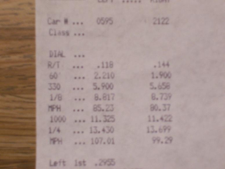

hello subie nation! i just got back home from Orlando Speedworld. i ran my fastest time to date. 13.6 @ 99.7 mph 1/4 mile. i have a 02 WRX wagon. she has all HKS exhaust both up and down pipes, STI intercooler, K&N with air intake silencer delete and GFB bov & mbc. i know mbc are frowned upon but iam taking it off her right now as i write. my question is, which i'll prob. answer, why go with EM when a MBC cost soo little ca$h? let the debate begin

hello, i just finished removing the MBC and hooking up the factory boost selenoid. i totaly agree with you, EM is the way to go. it's just soo $pendy, right now.
Attached Thumbnails engine management?-015.2.jpg   engine management?-017.2.jpg
