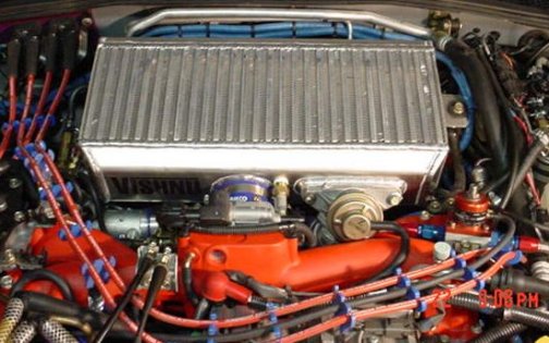

I would have to agree with Austin even though he was involved with their R&D.... Thats an ugly photo of it though ( test unit ).
The Vishnu TMIC is the only newly released oversized TMIC that isn't too large for the use of the sti spiltter / seal for a true air to IC effect. And from what I read about it they had designed it to work specifically with the sti splitter / seal combo. The new gigantic APS TMIC has a custom splitter also but I do not believe it incorporates a rubber seal to keep the cool air in and the hot engine air out, I maybe wrong though. In my opinion many of these giant TMIC's have too much surface area exposed allowing for an increase in heat sink effects. If I was buying a new TMIC this would be my choice.
