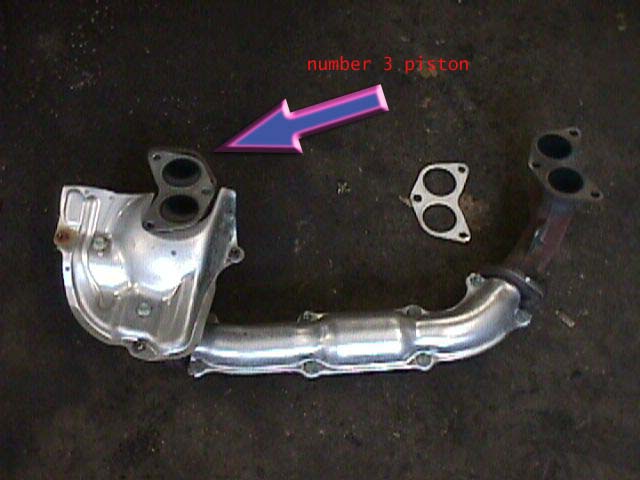

Originally posted by UU R X
number 3 piston is the one next to the up pipe or in front of the passenger firewall. thats the one i tapped into.
