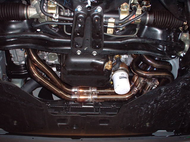

it all depends on the design of the actual header. a well designed 4-1 may end up having more low end torque then a cheaper 4-2-1.
the maxim is a 4-1 design. i noticed a torque increase across the entire band compared to stock. but keep in mind the true potential of the maxim exhaust manifold won't be seen with a smaller turbo like the stock td04.

i haven't heard of any headers that don't add a little lag if not more. are there any out there that don't? why not just swop out the uppipe and leave the stock header alone? i have heard of several people going back to stock after having an aftermarket header and being unhappy with the loss of low-end torque.
