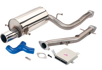

Originally posted by Subaru of Gwinnett
Stock car measured at circa 160 WHP
Stage 1 (circa 180WHP)
intercooler pipe
rear muffler
ECU re-flash
Stage 2 (circa 200WHP)
intercooler pipe
rear muffler
catless centre section
ECU re-flash
Stage 3 (circa 228 WHP)
intercooler pipe
rear muffler
catless up-pipe
sport cat down-pipe
ECU re-flash
Interesting that Prodrive has chosen not to replace the factory up-pipe until their Stage 3. I guess that with a re-flashed ECU in all Stage packages, the cat in the up-pipe should remain intact and not experience excessively high exhaust gas temperatures during part-throttle boost conditions. Vishnu also revised their Stage Sub-Zero upgrade when EcuTek re-mapping became available.
Anyhow, I'm glad to see a Prodrive presence on these shores.
