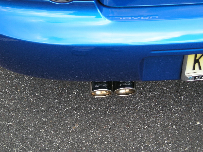

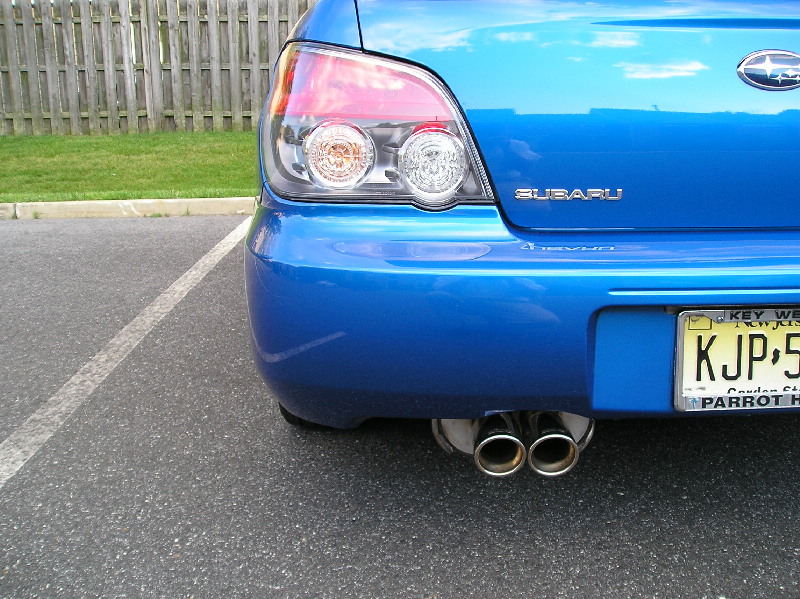

Old Jun 15, 2006 | 09:45 PM
equinn2823's Avatar
Posts: 81
From: voorhees nj
Car Info: 2006 wrx limited sedan
pics of the exhaust
here is a couple pics of the exhaust installed..
Attached Thumbnails borla hush and what else?-p1010158.jpg   borla hush and what else?-p1010159.jpg
