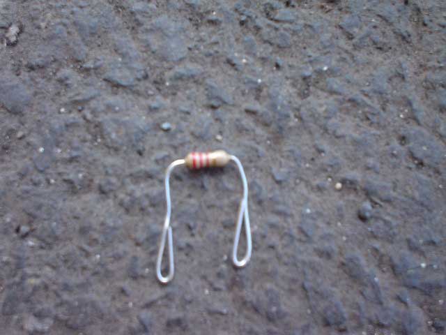

Yes. If the ECU "hears" a misfire for an extended period of time, then it puts the car into limp mode. Just like if you got a real misfire. This resistor mod... you are talking about an EGT resistor, right? The 2.2k ohm 1/4 watt resistor, I'm assuming. Check out the picture below. When you installed the resistor, did you form it like this?
If not, try it. You may not be making a circuit in the EGT sensor cable. Just a thought, though.

go ahead and switch to the 1/4 watt (they're cheap!). Also, the wire is pretty rigid, so when you bend the loop into it, it makes it a bit springy. This help it stay in the sensor cable slot. Works great for me.
