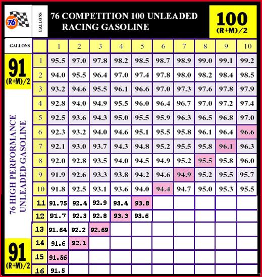

I typically use the Nos Octane booster, but I recently moved near the Almaden/ Foxworthy 76 station that sells 100 octane.
What would a good mix be?
I was thinking 4 gal. 100 and top it off with 91.

here ya go
https://www.i-club.com/forums/showth...+mixture+chart

I think 5 gallons of 100 topped off with 91 equals 94.xx octane. You can google "fuel octane calculator" and some links will come up.
IIRC an 02 wrx has a 15.9 gallon gas tank. If thats wrong my bad.

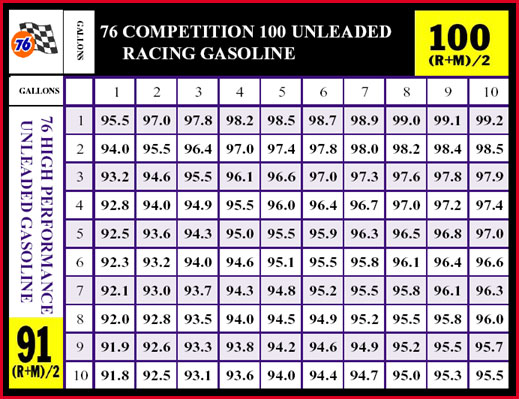

according to the chart I posted right after the OP asked his question, 5 gallons of 100 + 10 gallons of 91 = 97 Octane
Old Sep 27, 2006 | 09:58 PM
Max Xevious's Avatar
BanHammer™
Joined: May 2000
Posts: 47,596
Car Info: 2014 Forester XT
and for thoes that are too lazy to click a link
