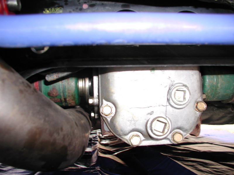

Drive Line Knock
Make dam sure the rear axels are cliped in to the rear diff!!!! I had one pop out
It is hard to tell because the viscus take up all the slack.
I had to rebuild rear diff new viscus and rebuild trany and I'm still not done I'm about 2,000 into it and still have 1,000 to go ................Ouch!!!!
