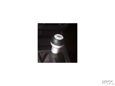

hi, i already did a forum search, and i've come to conclude there's a few brands out there. perrin, Kartboy, oem short shifter. But question is, is there really a difference in which one i get other than the brand/price. is there a difference in how to install it, and also, should i upgrade the shift **** itself also? because the stock shift **** gets on my nerves, i dont really like it. I've seen some momo's that are really nice. Thanks a lot guys

no clue what that shifter is but installation should be the same as every other one besides the STI which comes with the linkages. the other shifters are designed specifically for the impreza for height and gear engagement. so yours will probably be a different height and where the gears engage will probably be some place differen't.
the shift **** is all you. if you don't like it then change it. it is all a personal choice like rims. some difference but not life changing.
