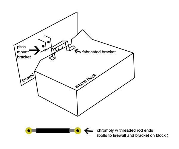

hmm lets see if I can explain this right,
it goes where the pitch stop mount is, but you need a bracket to bolt to the block on the engine with a pair of "ears" to bolt the other end of the rod too.( the pitch mount is bolted to the top of the trans )
When you take the intercooler off there are a few open bolt holes under the throttle body that can be used.
I made a bracket that bolts there and used a pair of threded rod ends ( one left hand thread ) and a piece of chromoly tubing with nuts that were welded into the chromoly.
One end bolts through the factory pitch mount spot on the firewall, the other to the bracket, you can adjust the angle of the motor by turning the rod which will lengthen or shorten and therefore change the angle. here is a pic I did real quick in paint to try to illistrate this.
hope this helps!
-Nate
hope this helps!
-Nate
