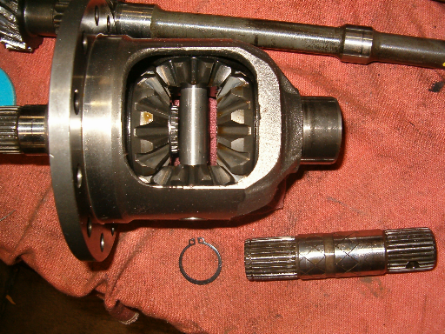

Now that post has me confused... One of my buddies took out his tranny to change clutch, and he pulled his axles off the tranny with the male end of the stub axles stickin out....
If your friend had an 02-03 wrx then I'd worry about this clip!
Andrew@Hillmuth

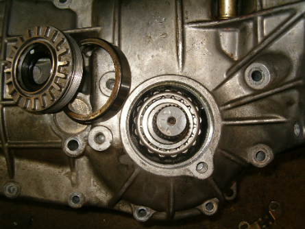

Cause your not getting it off or back on through here.
