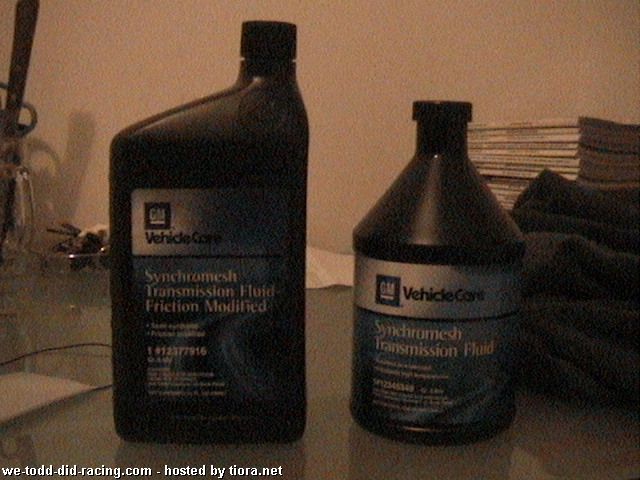

So upon further research I've discovered there are two "flavours" of GM synchromesh. One with an extra "friction modifier" added and a regular GM synchromesh. For those who tried synchromesh, what did you use? The friction modified fluid or the "regular" fluid? Someone asked about the part numbers, here they are:
GM Synchromesh Transmission Fluid: Part# 12345349
GM Synchromesh Transmission Fluid Friction Modified: Part #12377916
Old Jan 30, 2004 | 08:15 PM
Kevin M's Avatar
Posts: 18,369
From: Reno, NV
The friction modifier is an additive that helps clutch plates (i.e. synchros and limited slips) grip and match speed faster. That's what you would want.
