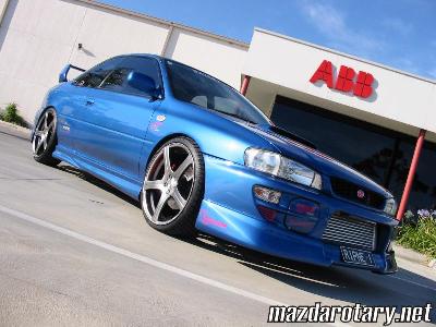

Whatever is in that picture, if it was sold from a dealership in the US, it wasn't a WRX.

However, Steve, There is no way you car makes 315HP with just those mods.

2. They never made a 2dr WRX in the U.S. 2dr WRX's were produced for Europe and Japan, but only in the GC8 bodystyle (pre-2002.) All 2002-present Imprezas and WRXs are 4 or 5 door, and all American WRXs are 2002-present. So, no USM 2dr WRX. You can turbocharge a 2dr 2.5RS as the EJ25 was built to be a turbocharged engine. It can get sort of expensive, though.
