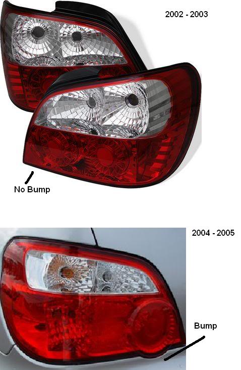

I have an 02 wrx and I was wondering if I could swap on some 05 sti rear taillights? I know I would have to change the rear bumper....will the 05 sti bumper fit my 02 wrx?

It should all just bolt on, I have seen a few people do this conversion going both ways.

No new bumper needed

No new sti bumper needed!? Please, please explain

well if you cut into your stock bumper then no you don't need an new bumper. A 04-07 Impreza bumper will do the trick. The only difference in the little lower bump that the 04-07 taillights have that the 02-03 lights don't have.

Here...
2006 - 2007 tails are the same shape, just a different brake/signal/reverse orentation.
You can cut out you current bumper to fit the newer lights but any bumper from a 04-07 Impreza (RS, 2.5i, WRX) will fit, a STi bumper might be too wide.
