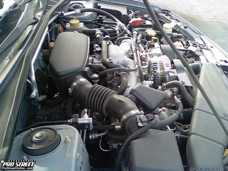

Ok Farran!
Here is his engine pics. We still need to see what inside looks like.
Go into the passenger side and take come pics of the ecu.
OK.
I would start of in getting some dyno's. You can either get the Gtech Pro or do to a place that does dyno's
You need to get a baseline before any other changes.
At least 10-20 runs in difference conditions, to get some good data for future reference.
I would start with a K&N Filter. Measure your filter dimensions and do to www.kandnfilter.com to get that filter.
Can your car be loud? If not, get a quiet exhaust, but I would highly recommend getting a HKS Carbon Ti for NA or Turbo muffler and increase your piping to 2.25". Find out what size it is right now. Change the piping from the header to the muffler. Check to see if you have any cat sensors.
Next step is a Ajustable Fuel Regulator along with the Innovate LC1 & XD1 (Kit) (http://www.innovatemotorsports.com/x...me.php?cat=252) and later on, a Blitz R-FIT for fuel controlling (http://www.blitz-performance.com/Blitz_RFIT.htm).
Also include in there a Grounding kit like HKS Circular Earth system (http://www.hksusa.com/products/?id=1506&rsku=0) and Sun Automobile HVS - MR (http://www.intakeone.com/Denso/SunHVS.html) for voltage stability.
There is other stuff, but I would like to see your Dyno graphs first.
With the filter and exhaust, you will be well over 200hp for sure, with alot of torque.
Attached Thumbnails Impreza 2.0R 2006-engine-view.jpg   Impreza 2.0R 2006-intake-manifold-view.jpg   Impreza 2.0R 2006-intake-view.jpg   Impreza 2.0R 2006-side-engine-view.jpg

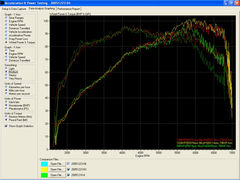

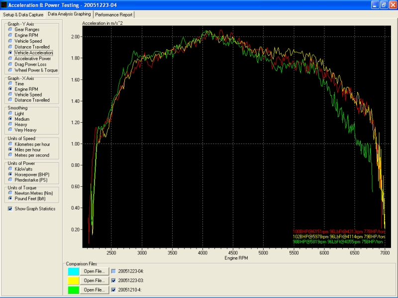

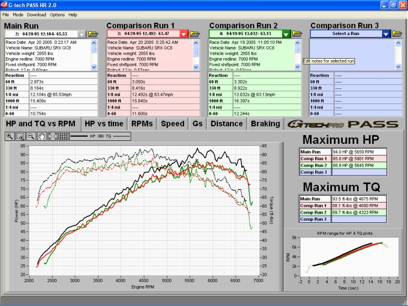

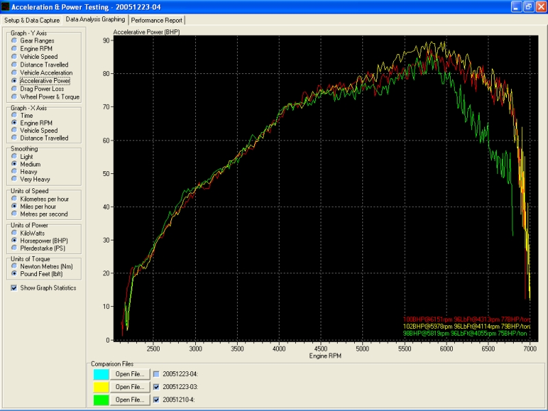

Here are my runs on a JDM 2000 Subaru Impreza 2.0L WRX NA/SRX Automatic with:
1) Custom 2.25" piping from header to Exhaust
2) HKS Carbon Ti Exhaust for NA models
3) 2x 2.5" internal Resonators - Magnaflow and Summit Racing
4) K&N Dropin Sport Panel filter
5) HKS Fuel Control - to combat pinging in CL. Did not work
6) Innovate LC-1 & XD-16 (Installed in December 2005)
7) Full STI Adj. Suspension
8) Whiteline Endlinks, ALK
All runs were in the evening where the temperature was around 28 degree celsius. Car works better in the night. It really pulls.
Car has AVCS + coil per spark plug
Attached Thumbnails Impreza 2.0R 2006-dyno-ej204-automatic.jpg   Impreza 2.0R 2006-dyno-ej204-automatic-hp.jpg   Impreza 2.0R 2006-dyno-ej204-automatic-tq.jpg   Impreza 2.0R 2006-2000-ej204-auto-gtechpro-dyno.jpg
