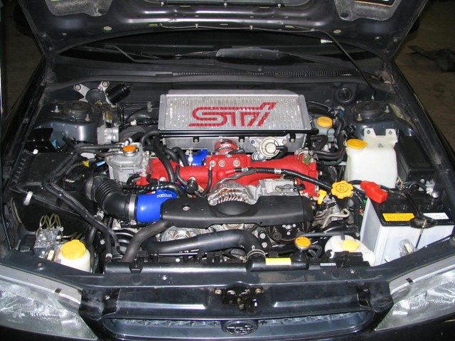

Basically like this, but not interior.

I don't have any links but friends of mine have '02 wrx engine swap and '04 sti engine swap into a RS.
To two of your questions:
1. The hood doesn't need to be replaced, my two friends are running with top mount okay, no problems.
2. You should replace the ecu with the sti ecu.
In my opinion you should find a wrecked sti and swap over the entire unit: including transmission, motor, ecu, and rear differential. By doing so you'd save a lot of work on wiring. I've even seen the sti front dash swapped in, to reduce a lot of wiring. (sti interior gauge cluster, etc.).
good luck
will
good luck
will
