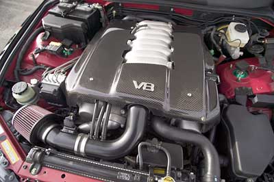

Now it is Lexus¡¦ turn to apply the formula. Yes, Lexus has gone muscle car. That bastion of muted elegance and understated solemnity wrapped in a cloak of Kaizen is out cruising stoplights looking for fun. The IS 430 is an IS 300 with a big 4.3-liter V8 engine wedged into the relatively small space once occupied by the 3.0-liter straight six.
Two similar cars were done a year ago by Lexus in Germany. Racer-turned-businessman Rod Millen did this project, his fourth for Lexus/Toyota after the Lexus Hot Rod (AW, Sept. 21, 1998), FJ-45 Retro Cruiser (AW, Oct. 18, 1999) and a 500-hp Celica that debuted at the Los Angeles auto show in 2000 (AW, Jan. 17, 2000). Of course there were also Millen¡¦s drives up Pikes Peak in Celicas and Tacomas, the fastest of which still holds the unlimited record of 10:04.
Making the big swap turned out to be far less complicated than you might think. New engine mounts were required, but the engine itself fit without modifying the hood, firewall or any sheetmetal. Only a few peripheral drives had to be remounted. The GS 430¡¦s radiator fit nicely, too. And since the V8 is aluminum and the straight six has an iron block, the two engines weigh almost exactly the same.

The new car has a Supra six-speed manual transmission, which required some modifications to the bellhousing to clamp onto the V8. But the Supra shift lever pokes perfectly through the hole in the transmission hump. Driveshaft and halfshafts come from the GS 430 while the differential is from a Supra.
The hardest part of the engine swap was not mechanical but electronic. ¡§The larger challenge was to develop an electronic interface that would allow the V8 engine to work with the manual transmission and IS 300 body¡Xsomething it was never designed to do,¡¨ said Millen.

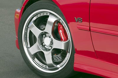

The monster IS received other adjustments, too: a more drag-friendly 3.769:1 final drive with a limited-slip differential; 16-way adjustable shocks; big, cross-drilled Brembo ventilated disc brakes with four-piston calipers; Speed Star SSR 18-inch wheels wrapped with Michelin Pilot Sport Cup tires, 225/40R front and 265/35R rear, and with ZR speed ratings; Rhys Millen Racing (Rod¡¦s son) front lip spoiler and side skirts to go with the IS 300 rear spoiler; a Chip Foose black-over-red paint job; and the requisite Mark Levinson stereo, in this case, a 720-watt multichannel system with 20 speakers.
