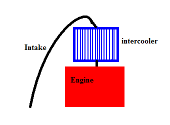

from what i could see (the new legacies have a stupid dress up covering thing over the top of the engine and intercooler) when we popped the hood the intake came from the side and around to the top of the intercooler. the intercooler had vetical bars then dumped into the engine (refer to ghetto picture below). I maybe wrong in that the air may come in from the side and not the top but everything else is right. in a day or two I'll get somebody with the new legacy to post a picture of the engine bay without the cover thing on.

very ghetto indeed

hey quit ragging on my drawing. Even if it is ghetto (which it deffinitely is) it serves its purpose and gets the point across. besides StrykerSTi should be posting a pick of the engine and intercooler of his new GT soon and then you can look at the real thing instead of my ghetto drawing.

roflmao that picture is great

Well i guess my dealer was right, maybe for the wrong reasons, but he was right. Maybe when I get one I'll have to do some airflow tests on it to see what benifits it has over the WRX one.

Well StrykerSTi posted some pics of the GT IC for me so you don't have to look at my ghetto drawing anymore. And now with that dress up piece taken off the engine I have absolutely no idea what the hell is going on with the airflow.
