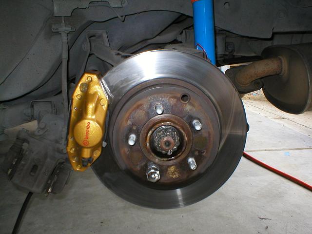

Yeah I just piked up a 95 SE last week, 150K miles and compression tested like damn near new, these motors go forever! And yeah, unless all you want is a pad upgrade, you will want to find a 5 lug swap, they stock brakes are SERIOUSLY tiny, Im talking 1988 honda civic small % lugs will also find you a few more wheel options, and lookie what I found out the other day, EVO rear rotors and STI calipers bolt right up!
EVO front rotors fit on too, Im just making a set of brakets for the calipers, EVO part outs usually sell the brakes front/rear for around $600 since nobody knows what to do with them, sweet!
