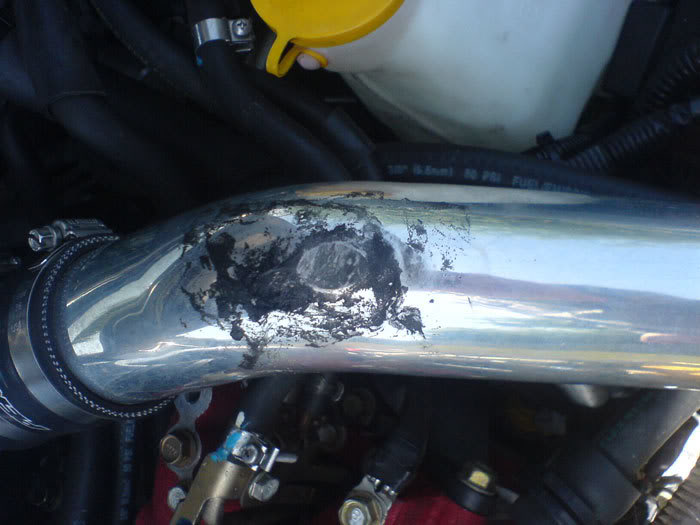

The Perrin Blow through MAF will wear through your top break line on your passenger side and will leak on your turbo. Fire? idk but possibly.

So it almost wore a hole through the blow through and was mm's away from brake fluidville.

Did you follow the instructions? You are supposed to relocate the brake line junction so the pipe clears. Have you tried contacting Perrin directly about this issue too?
We've installed many of these without a single problem.
I have the full pdf if you want it.
