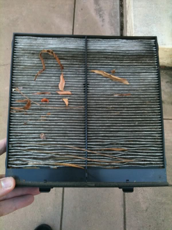

Time to replace cabin filter?
So apparently cabin filters should be replaced every year...
Mine has been in my car for potentially 3 years.
I pulled it out today and it looks like this...
Should it be replaced?

yes

naah it looks fine! just stick it back in and enjoy the fresh smell. muhahah

Holy ****. Havent replaced mine, ever. Had my WRX since 07
Ew 0_o

15k or 12 months is the interval, dumby.

Replacing it take ~ 15min There are couple of guys on Ebay selling replacements for ~$10
Really makes your HVAC work better to have a fresh filter in it

DAMNN helluh dirty... maybe i need to check mine

Replace it and check it often. Problem is the filter jams up with junk and the temp resistor chipset isn't cooled off effectively (good air flow), the chip will burn out! $150 for a 05-07 model and $60 for the 02-04 model. Filters are optional piece that can be inserted into any 02-07 blower box system. Just a rectangular cover that clicks and locks it into place.
