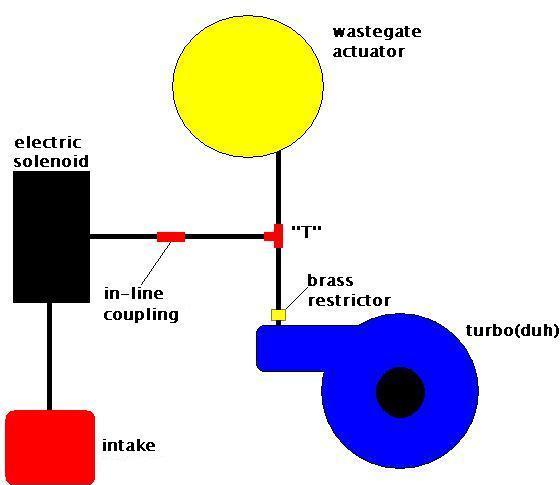

just wanted to make sure you know that the in line coupling that alot of people like to replace with a 3/16" coupling is not the actual restricor that regulates vacuum to the wastegate actuator, that is actually a TINY brass insert thats actually tucked inside the vacuum hose right in front of the turbo(see pic)
If you just replace the stock in-line coupling without replacing the brass restrictor you not get full stock boost.

I like many, just replaced the plastic vacuum connectors with bigger less restrictive ones...
Where do you buy the bigger sized brass connector that attached to the turbo?
What size do u use, and do you get the same amount of stock boost for all gears, or does it bump up the boost several psi?
Thanks, and GREAT diagram..

Well its not actually a brass conector that you can see by looking at the hose, its a small restrictor(about the size of a tic-tac, thats tucked inside the hose, from the outside it just looks like a lump in the hose right before the turbo, you wouldnt want to use a bigger one with less restriction since that would make you lose boost(more restriction=more boost) this is why it doesnt make sense to me why people that replace the T and plastic coupling say it gives more boost, anything that gets more air through that hose and to the wastegate faster should REDUCE boost
Anyhow, I wouldnt worry about finding a different sized brass restrictor, if your going that far just take out the whole mess and get a $25 manual boost controller.

Is this brass restricter also in the 2004 WRX because I just ordered all those lines from the dealer and I didnt notice anything in it.

i dont think it is...the brass restrictor is in the sti hoses iirc

the brass restrictor is in ALL 02-05 WRX, not sure about the 06 though.

btw, Mike at Gruppe-S should have some stock pills, otherwise try calling Subaru of Santa Cruz, or looking for the part number in one of the PDFs floating around the net.
+1 for yanking the tubes and getting a 3 port prodrive solenoid.
