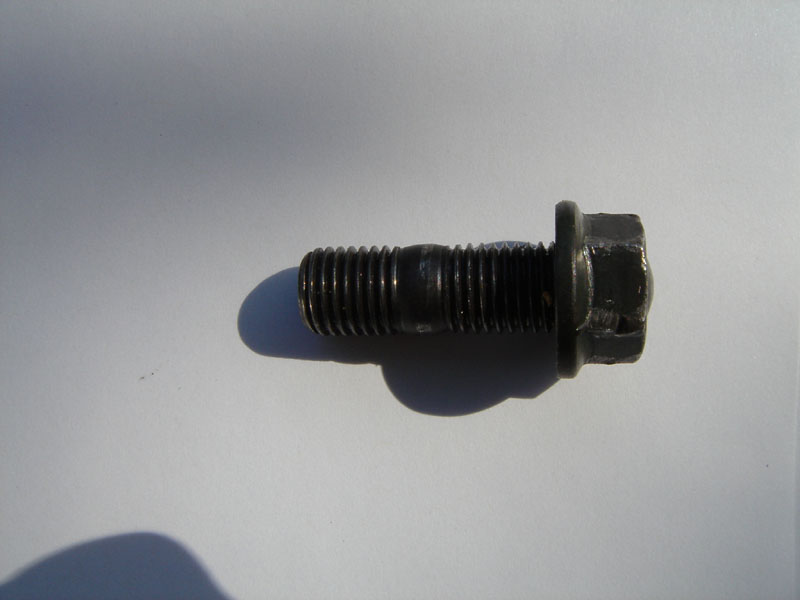

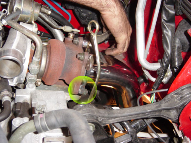

also... anyone know the part number for this bolt (see image) ?
it comes off the downpipe here (see pic)
TIA!

edit: for that bolt that you need....just take it to a suby dealer ship, show it to them and say "I need one of these" then proceed to tell them where it came from. They MAY just give it to you free....but if not, it cant be more than a couple of bux. Also, take it to a hardware store....its a metric bolt, but they may have one too, just make sure to get a "grade 8" bolt if you go to the hardware store, or other autoparts store.

oh and its a 14mm grade 8 nut and stud. you *did* replace that nut and stud... right? :x
The turbo exhaust side outlet stud from a subaru dealership should run you between $12-$15 and $1.50 for the nut. Both special order.
Did you use any WD-40 or PB blaster or something to try and crack any of those nuts? sometimes you gotta hit it 3-4 times and let it soak in before they will come out. then use some anti-seiz on the exhaust parts so they don't have to be replaced next time.

don't need to replace the nuts and bolts, just gaskets. did you torque all of them down to spec? should be like 26lbs.

Looks like the stud came out with the nut. It's happen to me on my 05. Just get them both replaced.

thanks for the replies... I did replace the bolt with something of the same pitch/thread and about the same length, I went to a local subaru dealer and i'm having the stud and nut ordered...fyi it's $7.50 plus shipping...and yes i did use WD-40 and they're all torque to 21ft/lbs.
hmm, for the turbo exhaust outlet bolt and nut, subaru of santa cruz told me $11.50 for the bolt, $1.50 for the nut. I assumed that they would charge more for a stud but I was WRONG!
