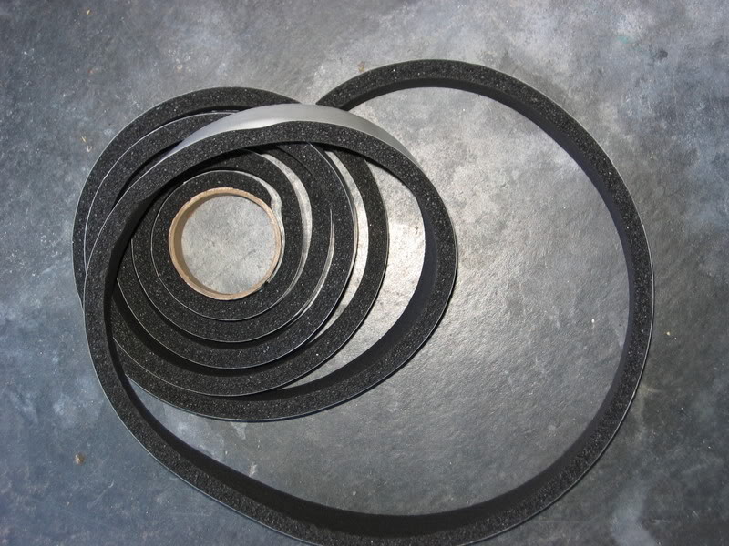

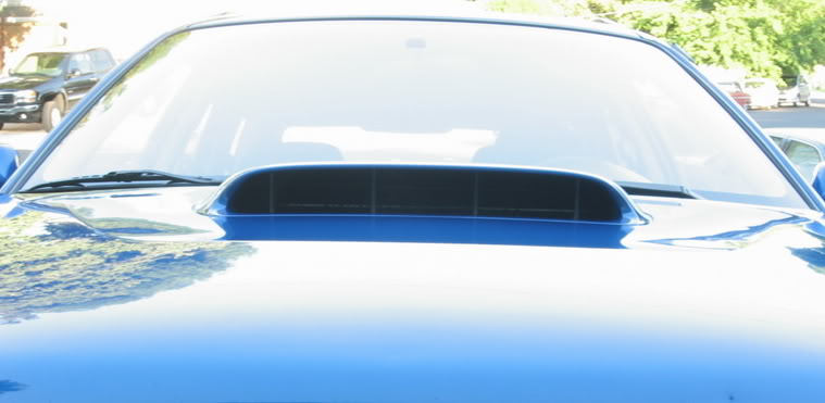

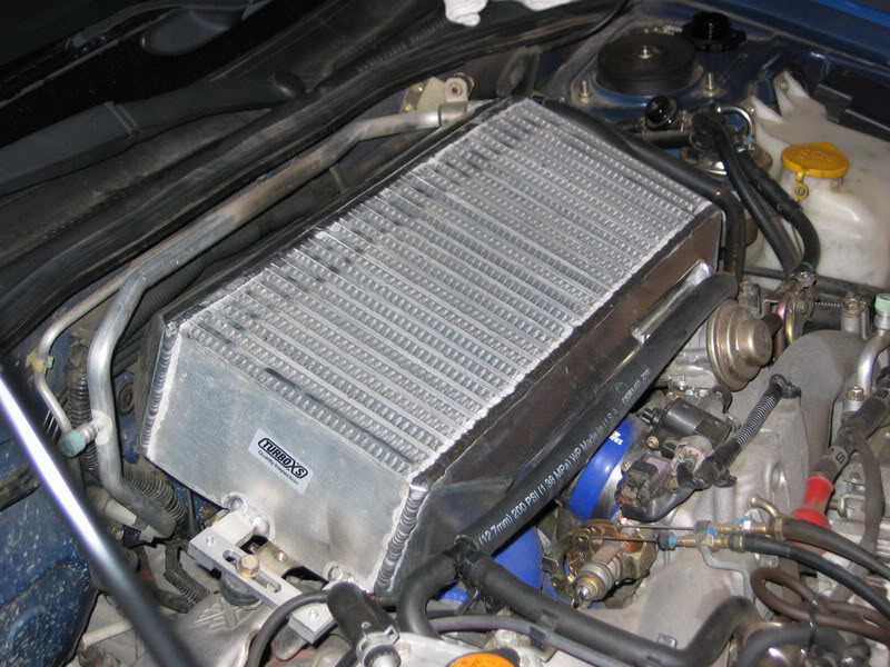

Here is my splitter shroud solution with my TXS TMIC:
JDM STi hood scoop

TXS TMIC
Weather Stripping

Suby OCD, I found your original thread when I was researching the v7 splitter. I'll probably do what you did; it looks like that weather stripping provides a pretty good seal. I'm guessing there's no danger of it getting too hot and combusting?
Also, I noticed you replaced your hard breather lines with rubber tubing. Since my Hyperflow tmic looks to be about the same size as your TurboXS tmic, is this something I need to plan on doing as well?

The TurboXS TMIC is a Hyperflow core, so they're basically the same TMIC.
Subie OCD - Is the passenger side mount a custom mount or is that what the TXS V2 looks like?

The stripping is holding up very well. Its been almost 2 months and it holds up well to the heat. I hope it does well in the summer months.
Yeah, I think Hyperflow made the TXS. The mount came that way.
