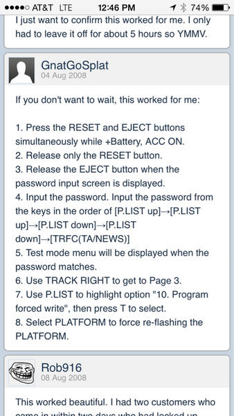

There's a sequence to it
Here lemme see if this posts.

Thanks for sharing! I've seen instructions posted all over Google, but wondering if anyone has actually done it... successfully. I'm afraid that I may end up worse than where I started

Yeah I recalibrated my coworkers through that. Updating firmware is another story.
