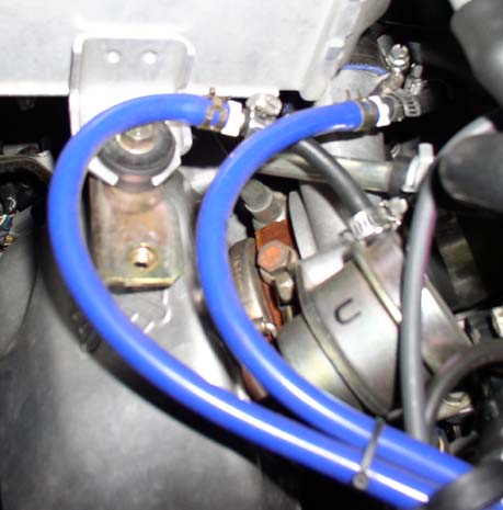

Old Jun 26, 2003 | 09:07 PM
KurleeDaddeeWRX's Avatar
iTrader: (26)
Posts: 1,959
From: Gilroy, CA
Car Info: 2017 WRB WRX Premium
Originally posted by shadowcat
mmboost:
I'm getting the same surging. Been trying to figure out why, and all I have in right now is the SBC Spec R EBC.
Kurlee:
Sounds like I've got the problem you were experiencing. What's the restrictor size? Since I didn't do the install, the EBC is mounted a bit far for my taste (rear firewall in the engine bay), and I don't have any of the old hoses or the restrictor. What's the size? Any chance of finding it at an auto supply shop? Where did you install the restrictor?
shadowcat
I used the 1/4" - 3/16" connectors that come with the kit. You can buy extra vacuum connector replacements at Pep Boys.
There is also a lot of info on this same subject in this thread:
http://www.clubwrx.net/forums/showth...=sbcid+install
Here is a picture of my boost hose setup. Silicone hose - 1/4" - 3/16" connectors - 3/16" stock hose. Sorry about the quality of the picture. I just ran outside and snapped a photo for you in the dark.
Attached Thumbnails Occassional bouts of surging when applying throttle-ebc.jpg
