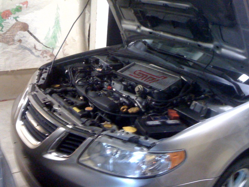

After lurking these forums for valuable information I thought I'd give back and introduce myself with some teaser pics.

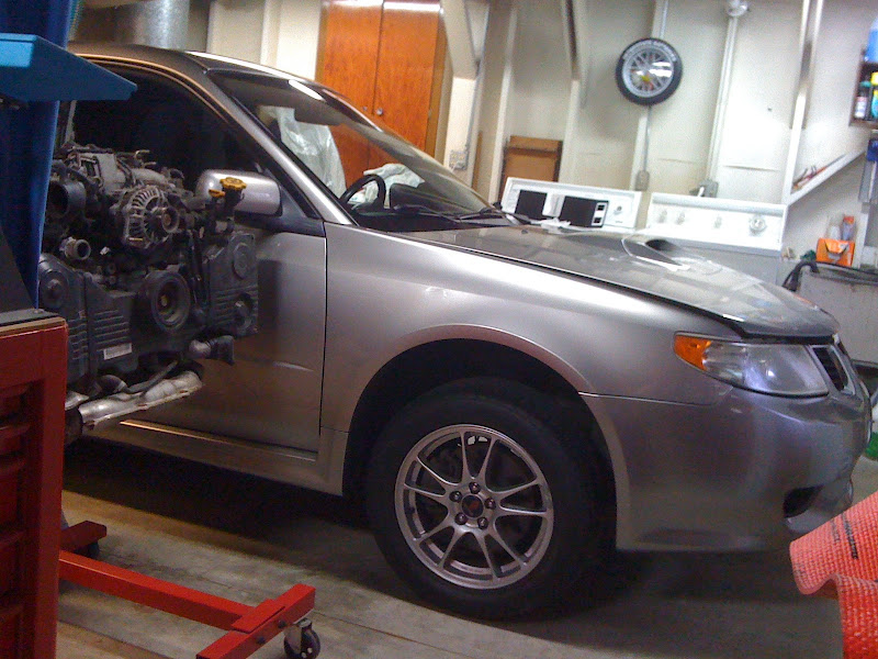

Picked up this 9-2x on the cheap because it had a light rod knock. Only wanted to do an engine swap, but came across a whole sti swap on the cheap.
Gettin my rally stance on.

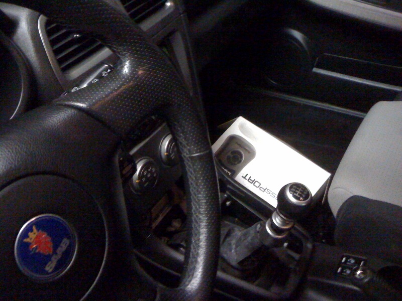

6speed in
Wish I could use the red intake
Went together without a hitch, until I went to start it. Flashed the tune, turned the key and nothing. Not even a click from the starter. Try the key a couple more times and still nothing. Then ah ha! Push in the clutch you idiot Boom fires right up!
Drove it down the driveway and turned it around. Front wheel drive only for the moment. Waiting on the rear brakes to come in so I can complete the swap.

Damn, nice job! BTW why arent you using the STI intake mani?

the motor and tranny on the cherry picker is a wrx motor right?
Old Mar 21, 2010 | 09:16 PM
Krinkov's Avatar
yes, or in this case, a 92x motor
Gotta rewire the whole car to use the drive by wire from the STI. Not something I had the time for. The TB is totally different, and the STI manifold doesn't have the idle air bypass that the wrx/92x does.
Might just get the wrx manifold powdercoated.
Old Mar 21, 2010 | 11:40 PM
Krinkov's Avatar
ah so your running an STI motor with a cable throttle, what ECU are you running it off of?
Old Mar 22, 2010 | 12:00 AM
SFO GTO's Avatar
Posts: 202
From: San Francisco
Car Info: Saab 9-2x Aero/Sti
Running it off the 9-2x ecu with just a cobb accessport. I saw an article on rewiring the tgvs to run the avcs, but gotta research it more before I head down that road.
Who did your tune?
Please don't tell me you're just using an off the shelf map..

Originally Posted by Ballz
Who did your tune?
Using the ACN sti pink vf39 sti tmic tune just so I can get it moved around the garage. Once its all wrapped up I'll be getting a proper tune.
