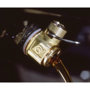

Wtf is fumoto? Lol
Old Jun 7, 2012 | 06:48 PM
slugrx's Avatar
Posts: 7,225
From: SF Bay Area - Peninsula
Car Info: 04 psm wrx sedan
Fumoto drain plug valve thing
And I use the oem ones, usually comes with the filter when I buy it..I have reused them before with no problems too

Originally Posted by imprezachiang
Wtf is fumoto? Lol
FUMOTO ENGINEERING

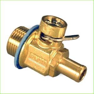

This is a fumoto valve. It bolts into the oil drain plug hole and you just turn the little lever to drain the oil from the car. I like the type with the nipple on it so you can connect a hose directly to your drain pan/jug and do a nearly drip-free oil change every time.
