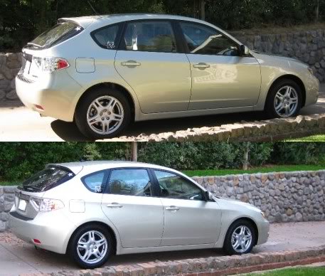

Swifts FTW!
I know wrong generation but they don't differ that much as far as drop goes.
Top: Before
Bottom: After
