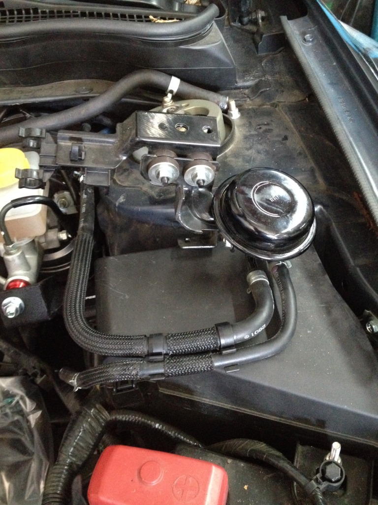

Anyone know what that horn looking thing is? I wasn't present when Mert and JoJo ripped out the engine...
Some sort of filter or seperator it looks like. I dont want to say fuel but could be a secondary fuel filter like the older wrxs have in the engine bay.
Fuel pressure regulator / Dampner by the looks of it.
