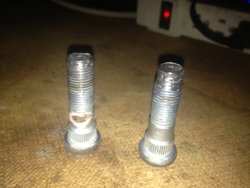

Super simple man. I just replaced 2 in about an half hour. They are $1.99 each at autozone and had to say that I had an 06 WRX to get the studs. They are the same on the 2008+.
Mine were super bad due to an air gun mistake.
Thanks Mike! I had a air gun mistake as well but done by Americas tire. I have a buddy local that had put on extended studs in the past on his car. He said he would help me out. I am going to do extended studs in the rear just for the heck of it since he has done it and said it isn't to bad.
