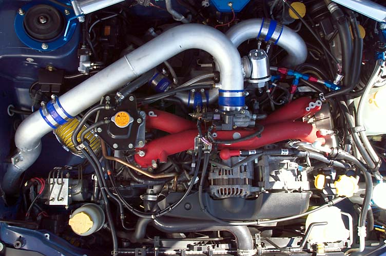

Great write up, one question is the piping on the cold side going to the throttle body smaller than the throttle body?

*edit* yup it is.
From the looks of it your own car certainly isn't lacking in piping diameter https://www.i-club.com/forums/attach...chmentid=27880

What's 4"? certainly not the throttle body.
Does the piping match the throttle body size or is it smaller than the throttle body?
I editted the numbers, since I kind of just forgot them (which is why I pointed to the relevant thread). 2.75" I just measure. The piping is 2.5"
It is smaller. But as I said in the above post, I was under the impression other fmics had 2.5" piping that flared to match the TB inlet.
