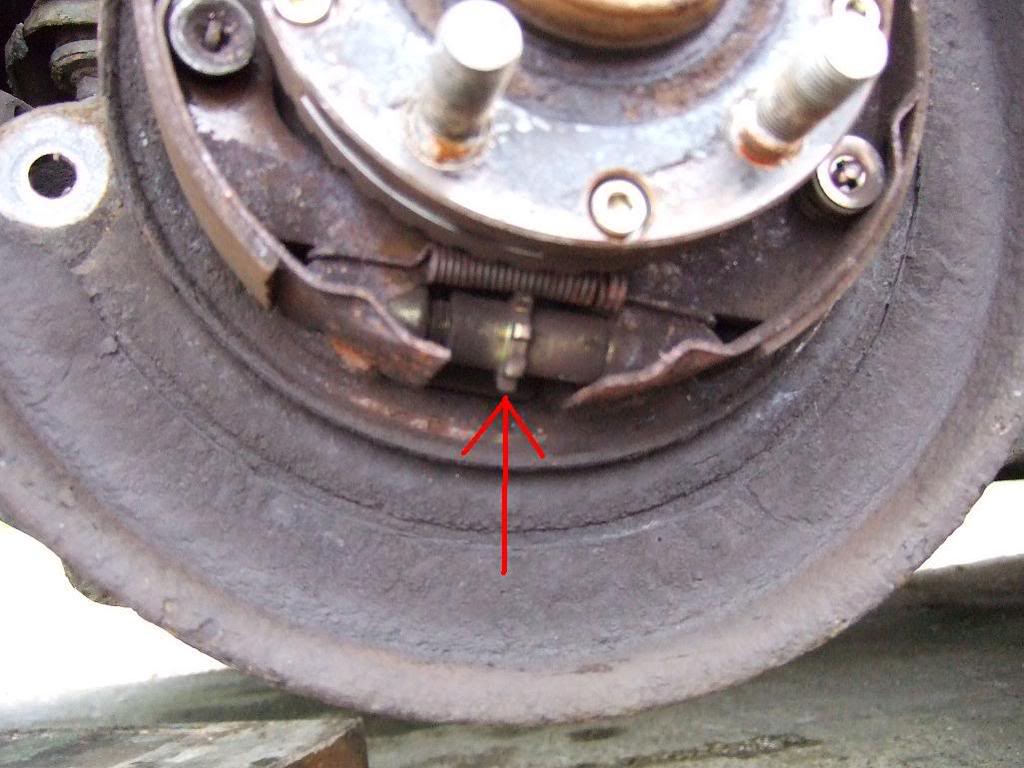

i have a full 06 lgt conversion on my 05 wagon.. did the conversion 5 months ago.. been great. The rears however..if you are going to get them done.. they need to be adjusted so that you hand brake can grab on to the rotor . there is an adjusting screw hole on the bottom( after pulling a rubber plug)
this is what you are adjusting:
you would need on of these hand brake adjusting tools to tighten up.
other than that its pretty much bolt on.
