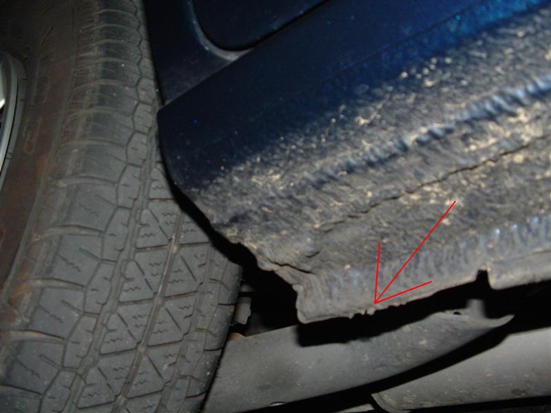

they are in the same place as the WRX, behind the front wheel well, and in front if the rear wheel well in the seam just under the skirt area.
here are a couple pics I just took of my girlfriends 03 civic:
Attached Thumbnails Help! where are the jack points on a 2002 Civic 4dr?-dscf0005-medium-.jpg   Help! where are the jack points on a 2002 Civic 4dr?-dscf0006-medium-.jpg

he's trying to save those spots for the jackstands.
since you don't have a rear diff to use as a jacking point, see if there are frame rails located inboard of the locations at which you intend to place the jackstands, and if so, use them.

yeah uhm, even with a floor jack you can jack it up and fit a jack stand under there, I did it on my own WRX when I installed the catback the other night, and when ever I rotate my tires.
