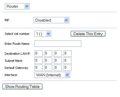

done... still nothing... what is RIP btw? Should I have it at Disabled, LAN & Wireless, WAN (Internet), or Both?
Old Aug 14, 2007 | 09:58 PM
DetailAddict's Avatar
Former Vendor
iTrader: (52)
Posts: 6,912
Car Info: Evo X
do i just leave these fields blank?
