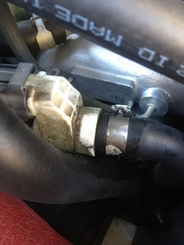

What is this part and is it common for it to do that?

I believe that is the PCV valve? What is it doing?

from what i can see it looks like oil is seeping out ever so. I don't think that is normal but im not sure. would like to know what that part is and if that is a sign of something wrong, or about to go wrong or if its ok and to do "x".
The valve inside can get stuck sometimes I think. Do a search on nasioc there are tons of threads about PCV valve problems.
A few people I know completely removed theirs as well but I don't think some people recommend that on a street car.

Thanks for the info i will look it up. The car seems to be running fine pulls strong. no codes. i was just under the hood looking over the motor and cleaning it up when i saw that and wanted to get some info. thanks again.

Its not a pcv valve but a sensor for the pcv system. the car is not throwing a code but still curious as to the oil that is present.

Sometimes those hoses getbhard and brittle and oil will seep out from hairline cracks. You can try to retighten the clamp or replace the hoses and use new clamps.
