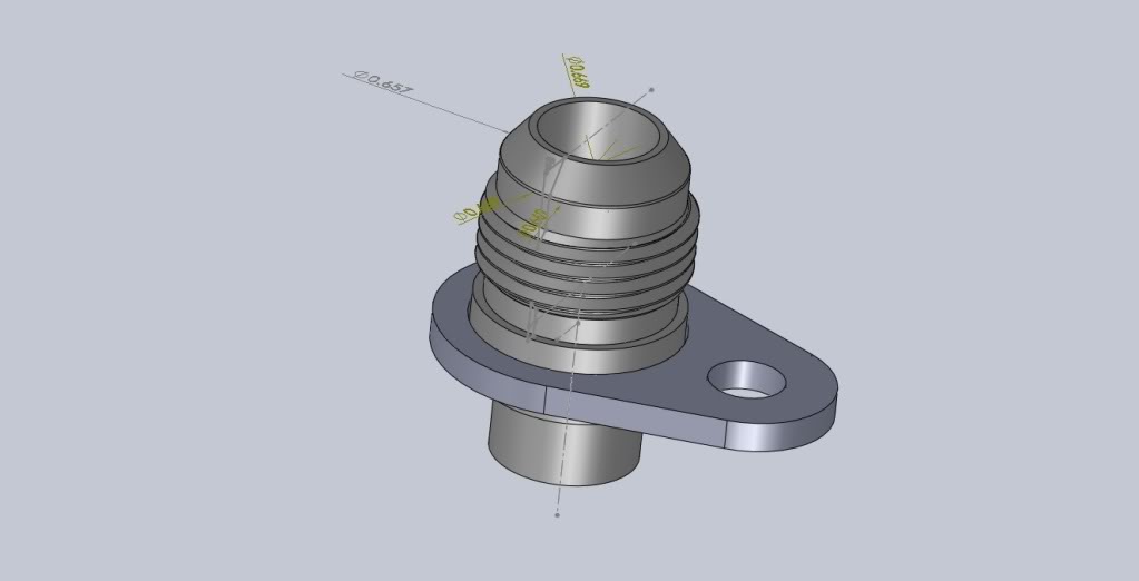

This is the fitting and the lasered bracket that gets welded to the fitting allowing you to fasten it to the power steering pump just like oem feed fitting. I know this works with the big plastic feed fitting but am unsure if the pumps that use the aluminum feed fitting have the same dimensions as the pump with the plastic fitting. So i can only say this works for pumps with the black plastic feed fitting until i can test fit this fitting on another pump. And again this is for the line that goes from the resv and feeds the pump with fluid. Im working on a p/s resv that fits in the stock location or maybe somewhere else for Mr. aboothman that has AN fittings on it to attach the return line from the pump and attach the feed line that feeds the pump.
