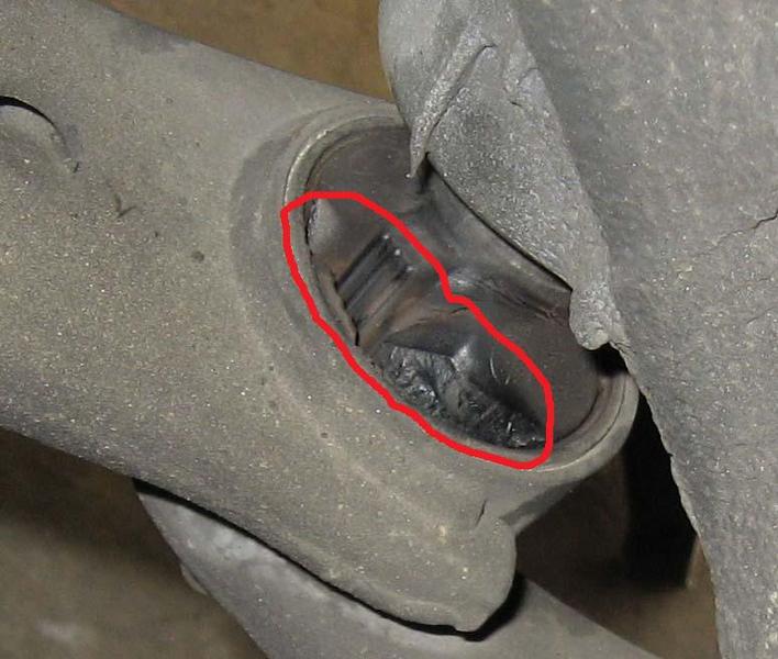

its a guarantee on all subarus...nothing spooky about it, I just work on them all the time
all those style rear control arm busings will be torn, you will need to kick and scream for them to cover it BUT they will if you know what you are talking about
if they have more than a 15mm tear they are covered under warranty (maybe it was 20-30mm tear, I forget, either way THEY ARE TORN for sure). But having them replace them will only save you for another 15-20k miles. We use whiteline kits, which are polyurethane and wont ever tear again.
Hope this helps

do the legacys have the control ar, bushing problem ?
Old Dec 24, 2009 | 07:21 PM
LICmotorsports's Avatar
Former Sponsor
Joined: Feb 2004
Posts: 3,426
From: 865 A Sweetser Ave.Novato, CA (new shop smell too)
Car Info: MY04 STi some call it a race car
not sure what you are asking but yes they have a rear control arm bushing issue
and yes the 05+ legacy's and newer gen models all have these same bushings and will result in same issue.

working on replacing my uppipe today , total b!tch btw , and noticed the RF control arm bushing looks like this , hope the warranty covers it
