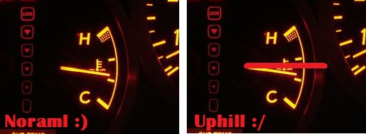

Updates (For others with similar situations) :
This problem is because of a head gasket failure & breach. Additionally due to the heads being slightly warped from overheating and or heat ups. I've changed radiator caps, burped the coolant system several times, and as time has gone on it seems to have only gotten worse. The car is pushing coolant into the expansion (Recovery Tank) and it also has bubbles in the coolant expansion tank.
I'd also like to point out the car passed several block tests. However the HG leak is so small that it really shows its issues while under boost (at first) and as time goes on it will happen under normal driving conditions and out of boost; However it was so small that the block test was always negative.
Regardless, bubbling in the coolant expansion is occurring when even at normal temps, or spiking, and or overheating. (Seems to be pretty constantly showing signs of bubbles)
If you see this on your car and you have checked the obvious things (fans, caps, coolant level, tstat, so forth), you might as well be starting to have a HG issue. Started very randomly and slowly and since only gotten worse.
Also in the picture of the example I have posted. The red line on the "uphill" (right side) represents where the needle would move to. (just putting that there to clear up any confusion)

Check the attachment for an example of the slight temp raise, it stayed in the "norm" zone but makes me wonder how fast it would have climbed on prolong uphill driving.

Looking at your gauge shots, it doesn't look like the temps went up that much for a long uphill. That small a change is normal. If you have the AC on, that can also boost coolant temps because the condenser is dumping heat in the airstream ahead of the radiator.
If the thermostat was not opening, then it would have overheated long before you got to the Altamont pass. I just replaced a buddies thermostat in his Mazda and he couldn't even drive the few blocks to the freeway before it was spewing coolant.
A FMIC will also increase your coolant temps if you have one.

Temp gauge is a 4 position idiot light.
