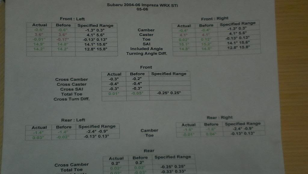

OK here it is.. Feedback

You're WNL

Strange...maybe look at your rack and pinion? Or maybe they aligned your car without centering your steering wheel on accident.

It looks to me like the car took some kind of impact on the left side... or maybe just had a poorly done alignment. I've had a situation where I performed an alignment on the rack, then turned the alignment machine off and back on and found that the numbers were not quite the same.
Your inner tie rod might have come a bit loose or not been tightened right during alignment.
I'd lift the front up and start shaking stuff until you find a wobbly bit.

I would start with getting the left side's Caster within Spec or at least equal to the right side's. From what I've read most negative caster is the side that the car will pull too so that should justify looking into fixing that.

Correct..the car had a left impact accident about 1 year ago..and does have a new rack an pinion on for a year..but the car was not pulling or I did not notice it until the new tires installed..
Are you stating something could still be bent?

So just came back from Alignment shop..They said the Caster was not adjustable?..wtf??
They also did find some play on the left tie rod that is attached to the rack and pinion...The mechanic staying in the car, while other looked at it..
When moving the steering wheel left and right, the left tie rod moved up and down.
Did we find the culprit?
