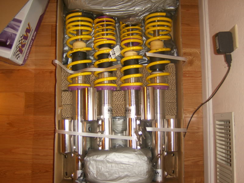

Whats up guys. I just received a set of these today
I hope to join the aggressive fitment club soon. Can anyone recommend me some good camber plates? Thanks!

Well the rears are a progressive spring so wont work with camber plates without being adapted, I would suggest Group N upper mounts for the rear and something like Cusco or Whiteline for the front camber plates.

I don't really have a budget, im just looking to dial in around -2.5 to -3 camber on the front and rear.
Right now im trying to find out more info on the Vorschlags because they make a rear camber plate with an optional spring perch made specifically for KW.

well if money is no object get the vorschlags front and rear, as like you said they have a different spring top for the KW's, and the bearings on the vorschlags look like they'll last a looooong time

I actually read that some camber plates slightly raise the car. (5-7mm) I think i read it off PDE's website.
yeah.. only problem is.. i spoke over the phone with a "tech guy" from vorschlag and when i asked him if the rear camber plates were compatible w/ KW V3's he didn't sound like he knew what he was talking about and he just confused me even more.

talk to Turn In Concepts (or RacecompEngineering). They should definitely know. I don't see why you would have a compatibility issue as they replace the top spring perch. (I would think) you just have to order the correct sized spring perch. Although I'm looking at that diameter right now, and not sure if they make the size for the larger springs. I would think they do.
