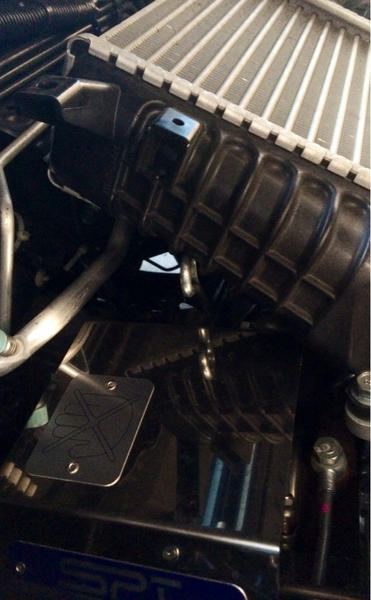

From reading a few forums, there is a pretty common issue in the 2008+ WRXs with the IC to TB hose leaking. You tube video sounds damn near what im hearing...
Going to try to get the IC off, and check these hoseclamps. Apparently Subaru uses a crappy rubber gasket under the clamp, which is unnecessary. There is also (apparently) a service bulletin about the issue. Most people report just removing the floppy rubber end pieces and tightening the hose down is fine.
We shall see... *crosses fingers*

Woah.
Ok that's deff the issue. One the IC was free it literally fell off the TB. Stupid clamp gasket is oily and fell right off... While it is fully tightened still

Going to clean this up and give it a test drive

Got it buttonned up, that TB to IC hose is a real pain. No more woosh leak! The crappy worm clamps crapped out on me though.. need to replace with T Bolts in the morning when Pep Boys opens.

Pull the rubber caps off both ends of that throttle body hose, reattach, and use hairspray to seal both ends to the intercooler. It helps prevent pop offs.
That OEM hose sucks tbh if you need a better one I have a brand new AVO one in my garage just sitting. I never used it because my front mount came with a Perrin one.

Got it all back on. The stock hose is just a bit short. I hate that thing so much. The T clamps made is bulkier, and slightly trickier to get tightend down but its on. Hasnt popped off yet *crosses fingers*
