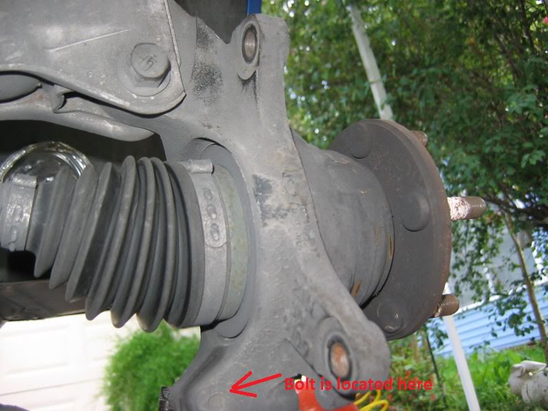

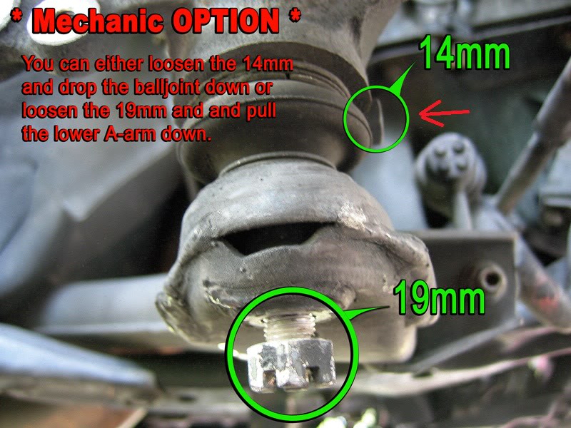

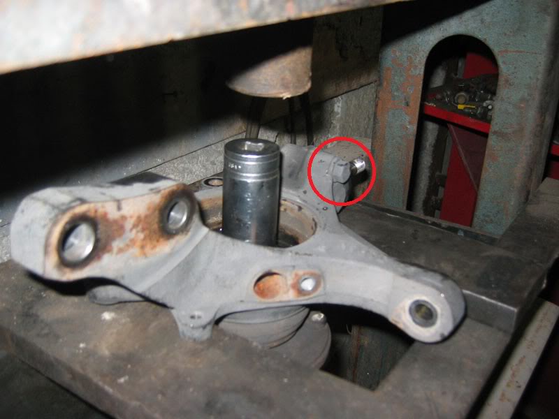

Not sure if I should post this in the classified or on the forums. Just borked a 14mm (thick) bolt that sits near the lower part of the knuckle. Anybody know where I can get this bolt, fairly quickly and cheap?
Seeing how GC imprezas are scarce in the junkyards... I guess a last resort is to drive over to the dealer and pick one up...
Also anyone familiar with extracting a broken bolt?? Especially a 14mm bolt that is pretty thick...... I was so close.... so close to fixing my wheel bearing FFFUUUUUUU!!!

pictures courtesy of Nasioc.
