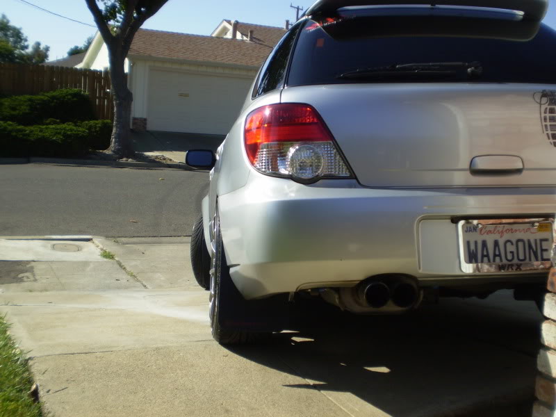

Here are some pics. These are 18x9's and coilovers.

what offset are those 9s? and what size tire? i think i see some stretch.
Offset is 35 and yes tire stretch, the tires are 225's They came with them when i bought them.

I wouldn't go that low myself - i have the baby car seat mod in the back (2 of 'em). If i do end up with 18x8.5, i might just stick with my swift springs/stock strut setup and roll rear fenders. On my previous bugeye sedan, i had 18x8 225/40/18 with h&r coilovers and it was fun on some freeway onramps but not good on comfort.
