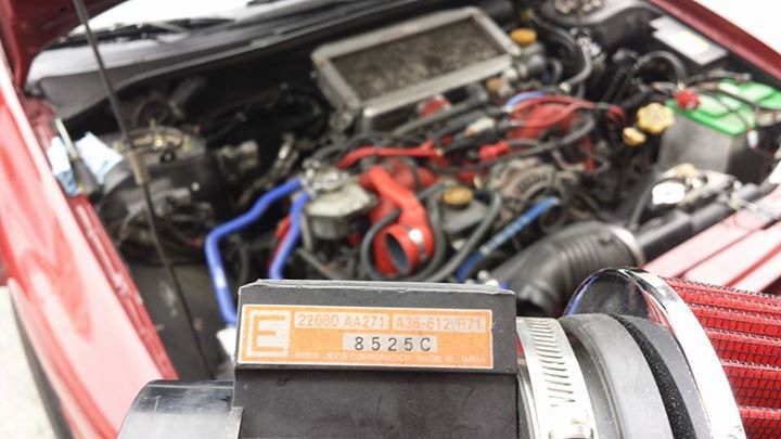

Anyone have an ej20k MAF I could try in my car?
My stock ej20k throws me a CEL Code 23 for MAF after about 30 min of driving, especially in warm weather, this never happens at night. CEL goes on and there is serious power loss, feel like a fuel cut. After a bit more cruising the CEL goes away and back to normal, happens more often on and off the longer I drive.
I do have a knock off MAF with which my idle is super lean around 18 AFR (But makes the CEL go away once it appears), with my stock MAF I'm at 14.7 AFR.
I will buy you food and or beer if I could try your MAF in my car for a bit, and maybe my MAFs in yours, if you're willing.
You're even welcome to drive my rSTI with it.
Located in San Francisco and willing to meet anywhere within Bay Area.
Thanks in advanced.
